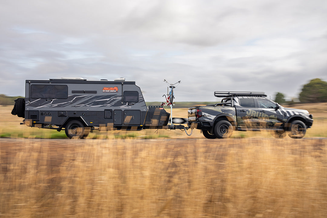

Towability
When loaded to the 530kg payload, it has an ATM of 2990kg, so most mid-range 4WDs can easily tow the Infinity. For our tow test, the Jawa-wrapped Ford Ranger looked great in front of the van, and it might be the perfect match. The narrow track of the van meant it fitted neatly behind the Ranger, and I had wide views to the rear through some MSA 4X4 Accessories Towing Mirrors.
The Infinity 15 towed smoothly, and the Ranger’s power kept us easily at highway speeds on the open road. There was no harshness through the hitch on the dirt section and no wandering in corners. Braking from the 12in drums was progressive and efficient.
