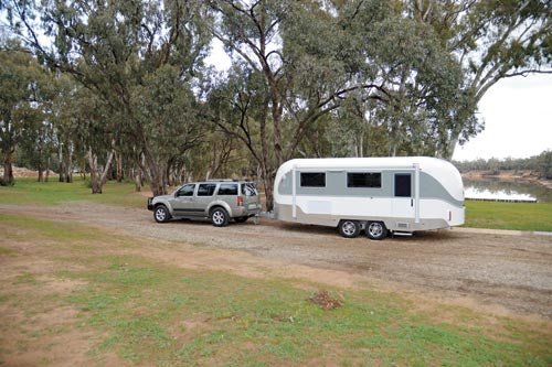

THE AEROVAN AERODYNAMIC CARAVAN
Alistair and Geoff Morrison of Echuca, Vic, had little experience with caravans before deciding to build their own: the Aerovan aerodynamic caravan. They were both into ultra-light aircraft. The first Aerovan had a G&S painted steel chassis topped with a 19mm-diameter steel body frame. Flat walls and a flat roof were created by gluing and screwing 3mm fibreglass to both sides of the frame and filling the cavity with polystyrene foam.
But while somewhat radical in appearance, the prototype was still built like a conventional frame-and-cladding caravan. It was with the second iteration of the Aerovan that things started to get interesting.
MONOCOQUE CONSTRUCTION
The steel frame was considered too heavy and old fashioned, so the Morrisons eliminated the frame and replaced it with a monocoque construction of 39mm-thick walls, roof and floor, consisting of 35mm of foam sandwiched between 2mm of fibreglass on each side.
Graystar Trailers of Melbourne was engaged to create the panels and wooden blocks were incorporated in areas that needed screw fixings, such as door jambs and the location for the swivel arm for the television. And, this time, the fibreglass ends of the van were double-skinned for added strength and to stop light shining through.
AEROVAN WEIGHT
Apart from simplifying the building process, the new construction saw a dramatic drop in weight to just 1650kg Tare – not bad for a fully-featured caravan on a galvanised steel chassis with outer body dimensions of 6.5m (21ft 6in) long and 2.4m (8ft) wide.
