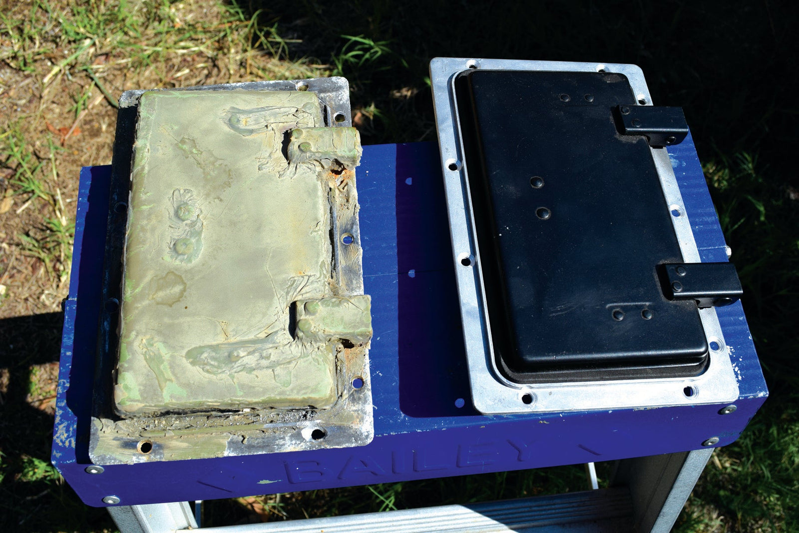

The rear module is from a General Maintenance Vehicle which had been cannibalised for parts to keep others in the aging military fleet on the road. In fixing some of the cracks in the 5mm fibreglass outer skin, I noticed the two scuppers on the roof were completely covered in silicone. You can imagine my sigh of resignation. As a 31-year-old rig, she’s verging on being an antique so it’s inevitable every problem you fix tends to reveal another. And so it was in this case.

Sure enough, once I started to peel back the inordinate amount of clear silicone around the vents, it became evident that every screw-head for both scuppers was burred over. Also, one scupper had a busted spring mechanism. This was going to be a bigger job than I’d originally anticipated.

After removing the scupper it was clear why 15 kilos of clear silicone was added around the vents. On original installation, the manufacturer had used a low-grade household silicone, and not much of it. This had dried and crumbled allowing water ingress. The silicone fix-it job that had first caught my eye was obviously an attempt by a military mechanic to get the rig quickly back on the road during its operational service. I’ll forgive him for that.

While waterproofing with a household grade sealant was the preferred option of the original manufacturer, I wasn’t about to make the same mistake. This time the new scuppers were getting a generous application of Sikaflex 227. It’s a purpose-made automotive sealant that’s fit for vibrations, can be painted over if you mess it up, and has sound deadening properties.
STEP 6: FIT NEW SCUPPERS
We found new scuppers online that matched the originals so we could use the same drill holes. This is where you’ll find out whether you messed up your hole alignments. Slowly insert the scupper into the cavity and align the holes with the nut rivets. When they line up, start screwing the bolts in, in an alternating order (bottom left then top right, etc), finger tight at first, then one last tighten when they’re all in. To ensure these scuppers are 100 per cent waterproof, we added one last bead of Sikaflex 227 around the outside.
