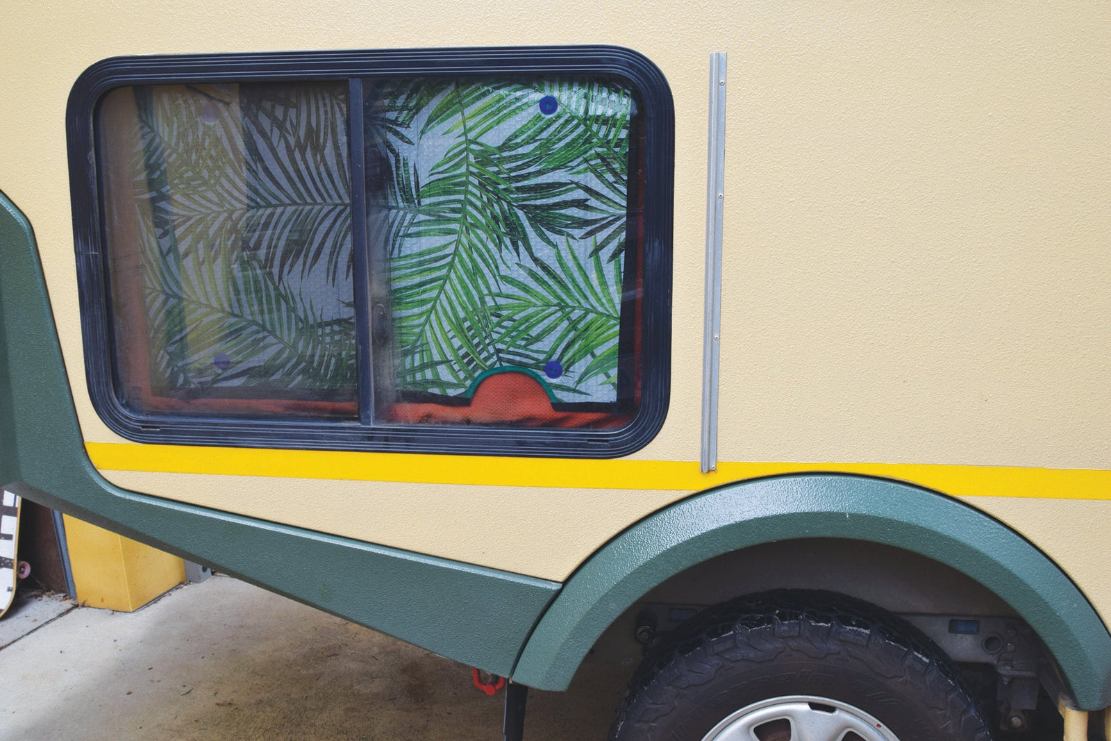

STEP ONE — Gather your parts
For our build, we used a couple of spare windscreen sunshades that we had lying around. If you purchase yours, take some time to find screens with either a patterned or subdued side so that you have a choice of shiny side or not. After that, all you need is a set of grommets, some suction caps, scissors, glue, duct tape and a knife. You’ll probably be able to scrounge most of these things from around the house. Grommets and suction cups are readily available from hardware stores.
STEP TWO — Measure twice and cut once
Minimise waste by measuring all your windows first. Using a whiteboard marker, draw out the shapes on the screen material, arranging them in a way that makes the best use of what’s available. By using a whiteboard marker, you can wipe off the lines if you get them wrong. When you’re finished and happy with the dimensions, cut out your pieces.
STEP THREE — Tidy up around the edges
Now, if you’re handy with a sewing machine, you could hem the cut edges. However, we opted for duct tape which looks tidy enough while still preventing the material from fraying/separating.
STEP FOUR — Line up your holes
The next step is even easier, mark-up where you want to have your suction caps and make a small incision with your knife. Take the time to balance and even-up the placement of the holes in each screen so they look good and properly support the screen material when it’s stuck to the windows.
STEP FIVE — Insert the grommet
We chose snap-lock plastic grommets that don’t require any extra work, but you could go with traditional metal ones with only a couple more tools.
STEP SIX — It gets sticky from here
It may seem a simple job to glue in the suction gap and, to be honest, it is. But you need the right glue.
The radiation from the sun will reflect off the screen and back onto the window. This will create a little hot micro-climate. If you use a glue with a relatively low melting point, the glue will melt and the screen will simply fall off, particularly for windows that predominantly face north. So, glue from a hot glue gun won’t work. Trust me, I’ve tried.
In addition, to make the job last, choose suction cups with the metal hook going though them. Remove the hook and recycle it. The remaining hole will fill with glue during assembly and will provide a stronger hold.
