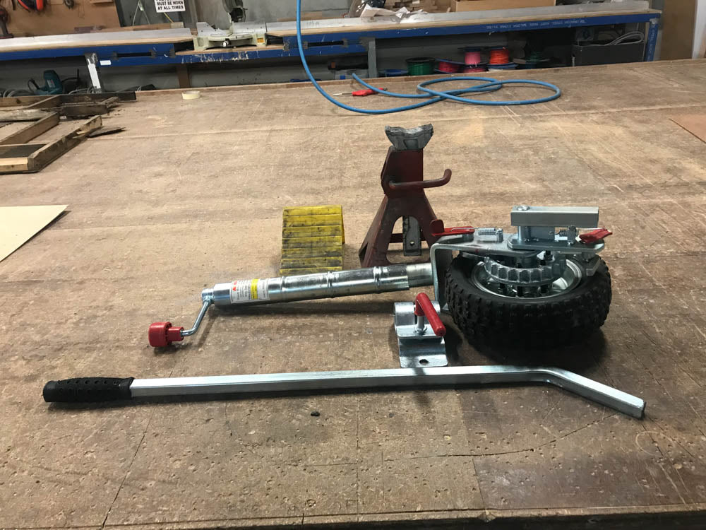

STEP 1
Engage the caravan or trailer's park brake or chock the wheels on the downhill side.
STEP 2
Place a jack under the drawbar while exchanging a standard jockey wheel for the AL-KO Power Mover.
STEP 3
Secure the AL-KO Power Mover to the drawbar.
STEP 4
Lower the Power Mover as far as possible on the telescopic tube.
STEP 5
Select directional settings on the two spring-loaded pawls.
STEP 6
Fit or engage the Power Mover traction handle.
STEP 7
Carefully release the caravan/trailer park brake and raise and lower the traction handle for controlled, easy movement.

As seen in these images, the AL-KO Power Mover’s user-friendly operation was clearly demonstrated by the RV Repair Centre’s foreman Paul Hewat — and all in only seven easy steps.
First, Hewat engaged the caravan's park brake, utilised a jack and chocked the rear wheels before securing the Power Mover to the drawbar.
He then lowered the Power Mover as far as possible on the 48mm diameter zinc-plated telescopic tube (around the fork of the unit), selected the directional settings on the two spring-loaded pawls, and then engaged the Power Mover traction handle.
Finally, after carefully releasing the caravan's park brake, Hewat raised and lowered the traction handle for controlled forward or backward movement.
