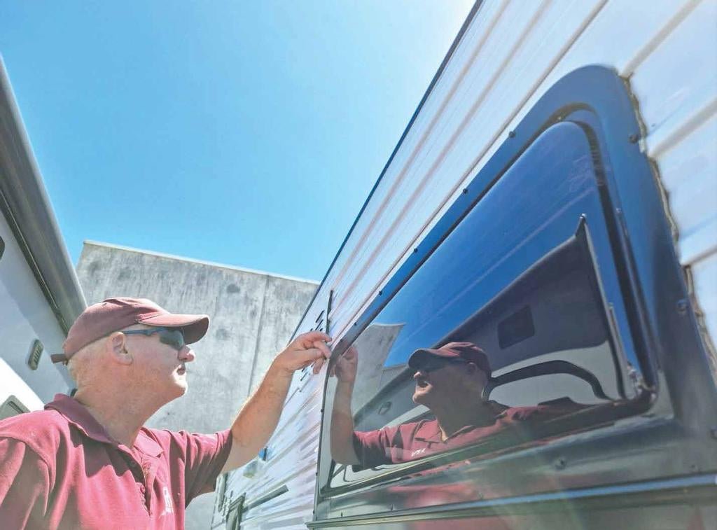

Window seals, particularly at the top, are another potential leak point. Sometimes window seals are formed with silicone and sometimes with a foam strip. In either case, inspect for signs of the seal coming away or deteriorating.
