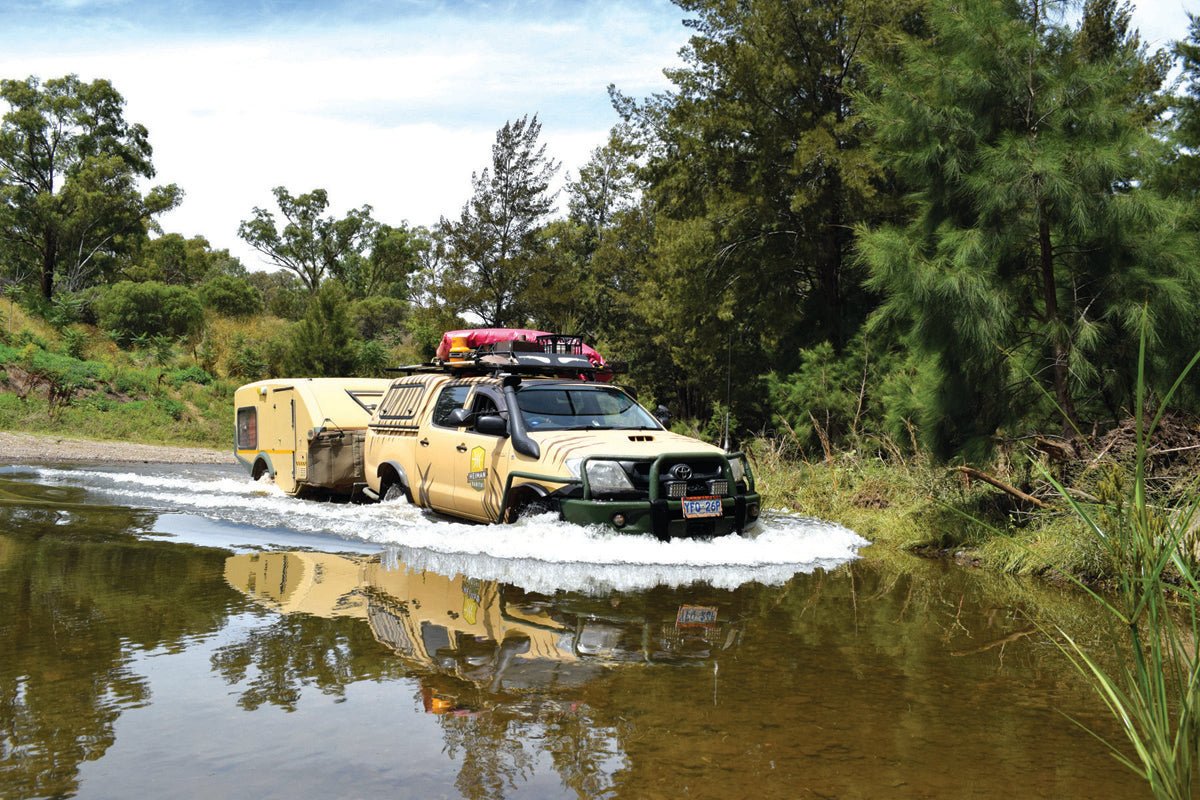

The first rule of creek crossings is that only one vehicle should be in the water at any one time — you don’t want to be the second vehicle when the car in front stalls, because then you then have to stop too. This would increase your risk of water seepage, getting bogged or even swept away.
Next is to engage low range 4WD and second gear. Drive slowly across, maintaining speed and revs, at a speed that will avoid water coming over the bonnet. What you want to create is a rolling bow wave in front of you and to keep up with it.
When driving across creeks, always have your window wound down (especially electronic ones) and unfasten your seatbelt. This gives you an avenue of exit if you stall as you don’t want to be opening the door. It also means you can escape the vehicle if you miscalculate the crossing and are swept away.
If your vehicle stalls in shallow water, try to restart the engine. If your vehicle stalls in high water — or if water has come over the bonnet causing the stall and you don’t have a snorkel — don’t attempt to start the car. This is because water may have gone into your cylinders, risking engine damage. Alternatively, you may have shorted out your ignition system and water is now getting into other engine and drive components. Conduct a recovery and call for a mechanic. Your electric winch may not work, so it's best to be recovered by another vehicle using their winch or a tow rope.
After exiting the crossing and reaching higher ground, let the water drain from the vehicle — being on a slope will assist this process. Then test the brakes before getting back on your way. Besides, you have to take off the water bra so take the time to inspect if the fan has struck the radiator, and let it idle for 10 minutes to dry off the components.
