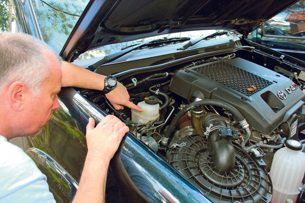

UNDER THE BONNET
While you’re under the bonnet, it’s a good time to check fluid levels and belt and filter condition.
The power steering will have a screw-on cap to remove and usually a dipstick for you to check that the fluid is between ‘min’ and ‘max’ levels. The brake fluid reservoir should be opaque so you can see that the fluid level is between its 'min' and 'max' level; the coolant overflow reservoir will be similarly constructed and marked as the brake fluid reservoir, so that also should be easy to check.
If any of these levels are way out of bounds, it's not a good sign and may be a task for a professional to correct. Bear in mind that brake fluid is very aggressive to paintwork.
