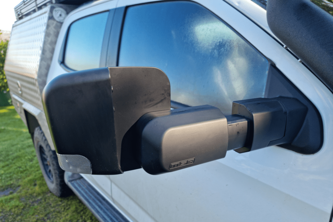

Some towing mirrors have two lenses which can be a little distracting as you are looking at two images. The MSA has one large single lens which I found very user-friendly. The mirrors have four different positions. Position 1 is the most compact and suitable for everyday driving without towing. Position 2 has the mirror arm slid out and is suggested for towing camper trailers and smaller vans. Position 3 has the mirror arm slid in, but the mirror head rotated 90 degrees to the horizontal position. It is suggested for ute-mounted canopies/service bodies. Position 4 has both the mirror arm slid out and the mirror head rotated 90 degrees to the horizontal position. It provides the widest view and is suggested for wider caravans.
A really clever feature is when the mirror is rotated to the horizontal position, the vehicle’s standard mirror controller still retains its normal up, down, side-to-side function.

Importantly, the mirrors have retained all their fancy functionality. And as actual mirrors, they do a great job. I found a couple of benefits for everyday driving. The mirror head sits in the vertical position, which is taller than the factory mirror. I found this helpful for reversing into parking spots because you can see the painted lines for longer into the reversing process.
I also found improved visibility of objects close to me in front of the bonnet. This is because the MSA mirror head sits on an arm protruding slightly out from the car body, creating a small gap to see through. Whereas the factory mirrors are close to the body, creating slightly more vision obstruction. This is handy for parking and four wheel driving, where visibility is critical.
The MSA mirrors have definitely improved visibility down the side of the service body, improving safety. And yes, they are good for towing!
