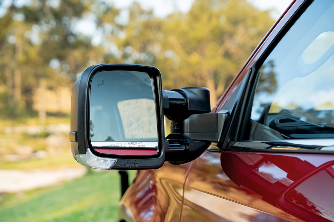

Set your mirrors correctly
Mirrors
Proper towing mirrors are essential when reversing a caravan. Adjust them so you can clearly see along both sides of the van and monitor its rear corners as it changes direction.
Use your mirrors consistently rather than frequently changing between mirror views and looking over your shoulder. A stable point of view makes it easier to understand the caravan’s movement. Scan from one mirror to the other, while also checking the position of your tow vehicle and spotter.
Reversing cameras and parking sensors can improve visibility, but they should be treated as additional tools rather than replacements for mirrors, direct observations and a spotter.
