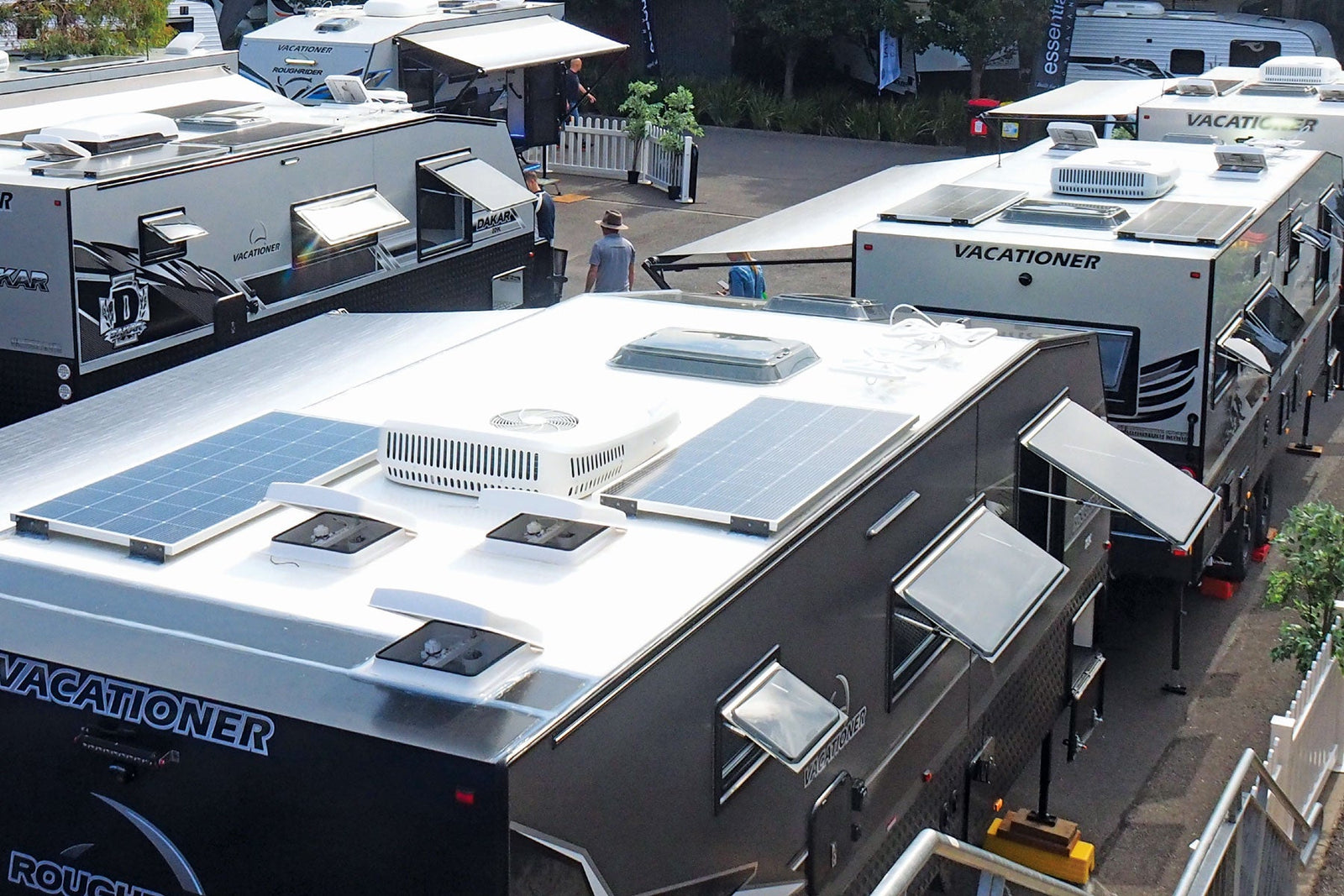

Caravans and motorhomes are ideal for a solar panel installation, although there are some energy losses in being flat rather than pointed more directly at the sun. Installation is a fairly straightforward process but given the characteristics of solar panels, it’s not simply a matter of connecting a solar panel directly to a battery. For a start, most solar panels have an output voltage that is higher than that necessary for battery charging. Secondly, a solar panel output cannot emulate either the multi-stage cycle of an AGM battery nor the constant voltage/constant charge cycle of a lithium battery. A regulator, otherwise known as a solar charge controller, is required to provide the most effective charge to the battery without overcharging. It also prevents the battery back feeding the solar panel when the installation has been correctly configured. There are two types of solar panel regulators - pulse width modulation (PWM) and maximum power point tracker (MPPT) — and both operate differently.
“Caravans and motorhomes are ideal for a solar panel installation”
