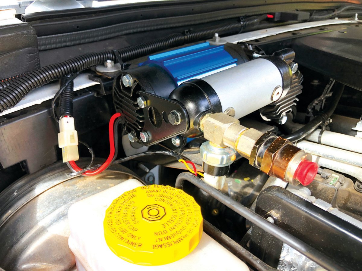

For convenience, an air compressor can be hard wired to your 4WD (like I have) making it easy and ready when you are, though most are optioned with a bag for portability.
