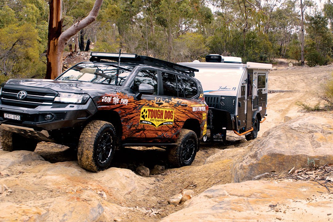

Towing safely with Tough Dog 4x4 Suspension (Image Josh Hanger)
