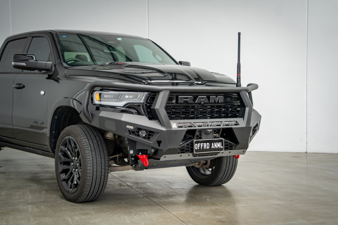

A quality steel bullbar and winch are the logical first additions, protecting the front of the vehicle while providing a genuine self-recovery option in remote country. The same goes for underbody protection, particularly if you're planning to spend time in rocky terrain where the Ram's long wheelbase and generous dimensions can work against it.

Bullbar
Offroad Animal Predator Bar
$4,500
+85 kg
Animal strike protection, winch compatibility and recovery points.
