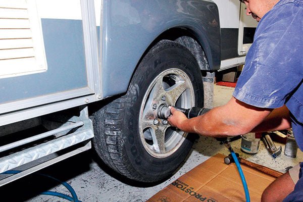

Now you can loosen off the van’s wheel nuts, but don’t take them off yet. If you haven’t hitched up your tow vehicle to the van, get something solid such as a block of wood or a brick and chock the wheel not being worked on.
It’s time now to lift the wheel you’re working on off the ground. To jack up the van, find a solid point under the van to lift it from. Either a chassis rail or underneath the leaf spring are usually the best spot. Then support the chassis with an axle stand. Undo the wheel nuts and remove the wheel. Then you’ll see the brake drum, on the centre of which is the bearing dust cover.
