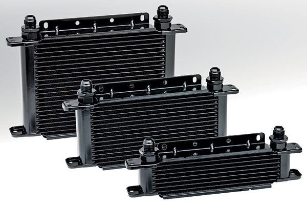

1. TRANSMISSION COOLER
Many tow vehicles are automatics these days, and the automatic transmission comes in for additional strain when towing. This strain causes it to run hotter and, while many modern autos run a transmission cooler, it’s often not enough. Many times, the factory cooler is incorporated into the radiator assembly, and was never designed to keep transmission temperatures down when towing in our hot climate. The most important upgrade for a tow vehicle is a separate oil-to-air transmission cooler.
It’s hard to give generic advice on this one – your vehicle might’ve come from the factory with an excellent separate transmission cooler, although more likely it did not. Best to check with a transmission specialist, a transmission cooler supplier or even on a vehicle-specific forum to see what capacity will best suit your vehicle.
Some vehicles also benefit from an engine oil cooler for towing, although that’s relatively rare these days. You can check with your vehicle’s manufacturer to see if they recommend an oil cooler or factory-fit one as part of an optional towing package.
