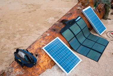

WHICH SOLAR TYPE?
To add further confusion, there are three types of solar panel on the market applicable to caravans and RVs: polycrystalline; monocrystalline; and amorphous. All three have been in Australia for many years.
Monocrystalline, made from single crystal silicone, came first, but in the ’90s an Australian company developed a way of multi-layering the crystal wafers that allowed the panel to become smaller for a similar output. Called polycrystalline, this technology features panels that are able to absorb more energy for a given area.
Both monocrystalline and polycrystalline are available in a range of similar outputs, are similarly rugged and are competitively priced. However, if you have to choose on the basis of size for watts, or you want the panels to operate in very high temperatures, polycrystalline will probably be your better bet for an RV, although monocrystalline panels are slightly more efficient.
The third type of solar panel is called amorphous. The main difference in this type of panel is its flexibility. It folds away like a blanket and can be draped over a caravan or an awning. It can even be walked on.
But to achieve the same output as a monocrystalline or polycrystalline panel, the blanket becomes enormous and the cost per watt ratio is much higher. For example, a 30W amorphous panel will cost around $700, and a 50W panel around $1100 – nearly double the equivalent rigid monocrystalline or polycrystalline panel. However, they have their advantages.
For example, a small blanket could be rolled up and carried in a backpack to recharge a satellite phone or camera batteries. Or it could serve as an emergency battery charger for a trail bike if you were travelling in a remote area.
If you want to run things – not just top up a battery – you need solar panels with a minimum of 80W, up to a maximum of around 300W. As these panels usually come in 50, 80 or 100W modules, you simply buy as many as you need.
As a rough guide, a good quality fixed 50W monocrystalline or polycrystalline panel with a 20-year warranty will set you back around $600; a portable kit model of similar power costs around $800. But remember that with a fixed panel there will be a fitting and wiring cost.
