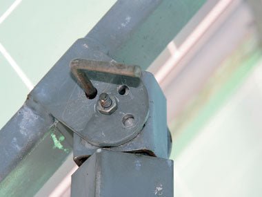

The rig’s construction is based around a T-shaped 50x25mm RHS frame bolted to the trailer, with a 50mm square steel post hinged on 5mm tabs sitting in the centre. A rotating 40mm round post, which allows the panels to be moved in a full circle, runs down the centre, and can be clamped to stay in any position.
A short length of the 50mm square tubing at the top is hinged on another pair of 5mm tabs welded to a length of 50x25mm RHS tubing, which supports the aluminium frame mounting the panels. The top tabs and the short section of 50mm square tubing are drilled to allow a pin to be inserted in order to hold the panels at the desired angle, thus optimising solar input.
The bottom sides of the two upper tabs are shaped to fit into matching cuts on the tabs mounting the lower end of the gas struts. This supports the frame when folded down on the roof and holds it securely during transit.
