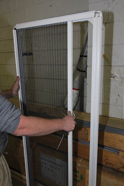

This job, to replace a caravan door, was commissioned because the owner wanted a more secure and durable flyscreen door than the one fitted as standard to his van’s access door. Because the screen was integral to the door assembly, the only way to fit a new flyscreen was to replace the whole door assembly. This is an interesting job because, on the surface, it seems very simple, but it is quite involved. While, in theory, anyone could do this – you don’t need qualifications to work on the door as you do with gas or 240V electricity – there are many opportunities to make mistakes. In particular, cutting out the caravan wall to accommodate the longer and wider new door is a bit tricky.

The new door was 21mm wider and 15mm taller, and was not completely square. This meant that measurements had to be checked and rechecked. In addition, a cardboard template was made of the top and bottom of the new door to ensure the radiuses we were about to cut for the new door were correct. Then it was time to apply a couple of layers of tape around the door aperture, so when the new opening was cut with the jigsaw it would not damage the outer wall skin. Then the cut lines were marked from measurements we’d already taken.

With the new opening cut, it’s time for a quick trial-fit with the new door. Using a tool such as Dremel, you can grind out any areas that have been cut out too narrow – hopefully, though, like ours, the cut will be spot-on.
Because the new door is both glued in and secured with screws on forward and rear sides, it needs pieces of timber glued in between the inner and outer skins so that the retaining screws have something to bite into. The insulation is cut out a bit more to make room for the timber, which is then glued in place.
