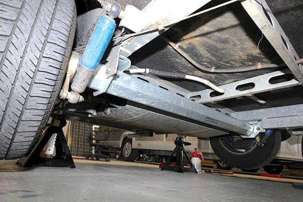

Jack up the van and place on axle stands. Make sure that the stands are supporting the main chassis rails – you can use the jockey wheel to raise and support the front of the van. This is where you can do your first check to make sure that the van’s brakes are working. You’ll either need to hook up a battery to the brake wire and earth for the van’s brake circuit or – and this is a hell of a lot easier – plug your tow vehicle into the van. Get a helper to apply full van braking at the electric brake controller and see if you can spin the van’s wheels. The wheels should be locked solid.
Now the wheels can be removed, and it wouldn’t hurt to tuck them under the van while you’re working on it. It’ll reduce the chances of you tripping over them and gives you a back-up if the axle stands tip over. If you have decent axle stands with a wide footing, this should be a very unlikely scenario – but it pays to be cautious.
