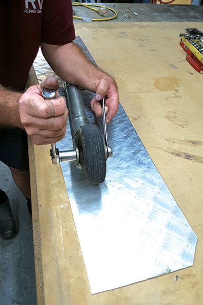

STEP 2
Removing the solid jockey wheel from the lower case requires a spanner at each side on most designs. Remove the wheel and inspect for deterioration and axle shaft wear. Replace any defective parts.
Handy hint: It’s preferred not to hold the casing in a vice to perform this task as the pressure applied may distort the outer case.
