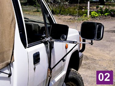

It’s common sense to know as much as possible about what is in your immediate driving vicinity. The first pieces of equipment that will help are good side-view mirrors. The law in all states requires a clear view of following vehicles behind the caravan or trailer. For this reason it’s usually necessary to have extended side-mirrors (see pic 02) on a tow vehicle to give a clear view of what’s behind the caravan or trailer.
Extended mirrors can reach out as far as 230mm when towing, but when not towing the extension limit beyond the car body is 150mm. If you are following a caravan and cannot see the tow vehicle’s mirrors, that driver is operating illegally. Multi-mirrors are the best choice if they can be used on your vehicle.
