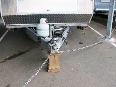

Our retirement village has tie down points for every RV. According to regulations, if you do not have your RV tied down with a specified size of chain or rope, it must be removed from the village. Also, all wheels must be chocked, front and back.
In our section, heavy chains about 800mm long have been welded on to the large steel posts supporting the roof. These are positioned so you can attach your own chain or rope to each corner of your van. In another uncovered RV area, heavy lengths of chain have been concreted into the slab near each wheel, plus another single point for the A frame.
Chains work to anchor your RV to the spot, but they may save only the chassis in a severe cyclone. If you wish to make it more secure, I suggest attaching straps to the tie down points and crossing them diagonally over or around your van.
In this situation, you can protect the RV body from chafing by enclosing the straps with rubber hose, or by jamming a towel underneath at points of contact.
