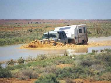

When confronted by a water crossing it is advisable to initially make an assessment of the depth of water and the amount of time it will take to complete the crossing. Sometimes this will mean stop, turn around and go back, or else wait until the water level or distance is less. If you wish to proceed it could involve a little or considerable preparation.
If the van floor will be clear of the water surface, then it’s likely you can manage with minimal preparation. If there is a visible road surface all the way through and the water is tyre deep, it’s likely that no preparation is required. To find out whether water might enter the caravan during the crossing, measure the height of the caravan floor from the ground. Then add another 150mm at least because there may be unknown potholes under the water surface.

A word of caution: vans do not behave predicably during water crossings. I have seen poorly prepared vans scoop water and emerge from the crossing in a dreadful condition, bowed down due to a huge weight of water inside, virtually wrecked in moments. Others have been so well prepared (and light) that they have literally floated. When a caravan floats, it will swing around due to the current and possibly smash into the rear of the towing vehicle.
