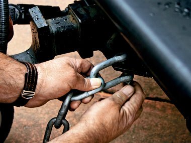

With coupling locked in and the jockey wheel raised and put away, it’s time to secure the safety chain(s) and plug in the trailer electrics. Make sure the chain length is sufficient to reach the locating point(s) provided on the body of the towbar while being able to negotiate corners, and never secure the safety chain to the removable towbar tongue.
If the chain is much too long you can get links removed or simply secure a few links from the end. Don’t be tempted to nip up a shackle with pliers, as you’ll find it next to impossible to release later. With two chains, make sure to cross the chains so that if the coupling does come off, the chains will stop it from hitting the ground.
