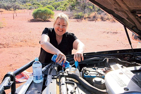

CAR COOLING
Of the key maintenance items that make up a pre-trip inspection, your vehicle’s cooling system should be at the top of the tree. I’m not talking about the air-conditioner or those four glass windows that move up and down, but the radiator and its related parts.
As you may know, regular servicing doesn’t cover every item at each interval, which is why it’s important to let your mechanic know your travel plans, so he or she can check the vital components prior to any extended trip. Towing puts considerable strain on your vehicle’s cooling system requiring it to be in top-notch condition.
I know all this from experience. A month into our big lap, we noticed higher than normal temperature readings on the gauge, as we were winding our way through the tall timber area along the south coast of Western Australia. Sure enough, we found stinky coolant blowing out the overflow pipe and down the inside of the front guard. Mechanics crawled all over the car trialling different solutions and scratching their heads, as part of the test and replicate process, but to no avail. Yet pop the van on, and the problem was almost instantly replicated. It ended up being a warped head which cost us over $5000 to repair and the loss of four weeks from our trip.
Compounding the problem, later in the trip, our low coolant alarm developed some corrosion on the reading element, causing the alarm to sound erratically from time to time. It only added to the paranoia.
Funnily enough, there is a native bush down the east coast that smells a lot like coolant. It didn’t help our situation and caused additional stress and worry about another impending expensive repair.
