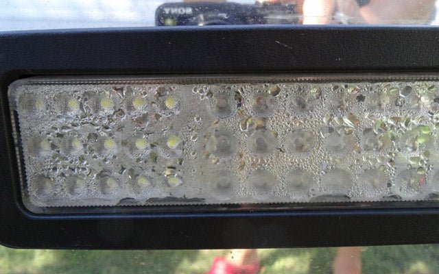

It had been very wet, and the reputedly sealed LED indicator lights on the bull bar of our new car had filled with water.

We were told by Ford Australia to find a Ford dealer, but the closest was over 1,000km away. ECB bull bars came to our rescue though, and express posted a couple of replacement indicator units. The final caravan owner was able to have his bearers welded in town, and his departure was not delayed.
