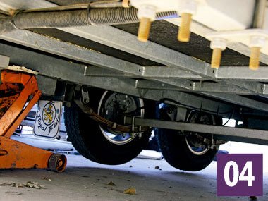

04 With the jack on a solid base, elevate one side of the van so that the wheels clear the surface.
