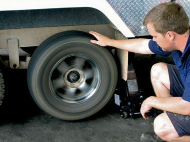

10 Fit wheel (if you haven’t already done so) and tighten nuts enough so it’s secure on the hub. Spin the wheel to ensure it’s moving freely, then grab the top and bottom and see if there is any movement. If the wheel is binding you may have overtightened the bearings and need to loosen to the next pin hole. If not tight enough, the wheel will have some ‘play’ in it. If you do not need to recheck bearing tension, return wheel to the ground, remove jack/axle stand and tension wheel nuts. Check wheel nut tension again after 100km.
