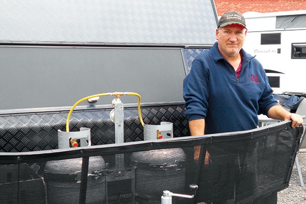

These images depict the installation of a Coast to Coast brand stoneguard by The RV Repair Centre foreman, Paul Hewat. It was fitted to a Coronet RV Explorer XT2-5950 model.
1. The Coast to Coast caravan/camper stoneguard comes complete with the frame, mounting brackets and mesh insert. So it’s ready for the DIY install.
2. Use the fixing bolts and follow the user guide to assemble the frame correctly.
3. Next up, install the lower stone flaps using the brace support prior to positioning on the A-frame.
4. Position the stoneguard on the A-frame and use pencil or crayon to mark mounting bracket locations on each side of the chassis rail. Handy hints: Use G clamps to hold the stoneguard in position; measure off to ensure the guard is central to the caravan/camper body; and take into consideration clearance for gas cylinder and weight distribution install and removal.
5. Remove the stoneguard from the A-frame and place the mounting brackets on the A-frame where marked. Handy hint: Take note not to interfere with the handbrake cable where installed.
6. Affix the brackets to the A-frame with the bolts supplied.
7. Add the mounting plate support to the A-frame bracket as shown.
8. Add the mounting plate insert to the stoneguard framework as shown on both sides.
9. Affix the bolts to all mounting plates. Handy hints: Leave the mounting bolts loose and re-tighten when the stoneguard is installed on the A-frame; the base support bracket has slots to allow for final adjustment.
10. Place the stoneguard into position on the A-frame as shown above. Handy hint: Recheck measurements and use the slots in the base support bracket to centralise the stoneguard.
11. Re-tighten the base plate bolts after final measurements are completed and place the C clip to hold the stoneguard as shown. Handy hint: The stoneguard can be removed any time by removing the C clip.
12. Once the stoneguard frame is mounted on the A-frame and all bolts are secured, it’s time to prepare the mesh supplied in the DIY kit.
13. Place the mesh on the front of the stoneguard and, if necessary, use G clamps to hold into position. Handy hints: Whilst not shown within this image, use a pencil or crayon to mark out the location of the self-drilling screws as described within the user guide; Then use a battery drill to install the screws as shown.
14. Continue fixing the mesh mounting screws as shown. Handy hint: Ensure the mesh is consistently tight to avoid wrinkles when fixing.
15. You’re ready to enjoy the benefits from your DIY Coast to Coast stoneguard.
