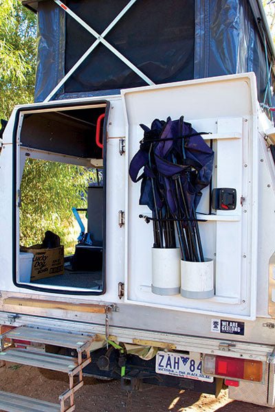

CAMP CHAIR CARRIERS
Stuck for a good way to stop your camp chairs sliding about when stowed? David Smith from Geelong, Vic, has a solution. David mounted two short off-cuts of poly pipe with caps on one end to the rear door of his Tommy camper. With the capped end at the bottom, the poly pipe acts as a base for the chair legs to slot into while bungee cord is looped across the top of the chairs and attaches to rope buttons to keep them in place.
