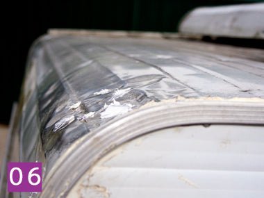

04 Using a screw and a pair of pliers, we were largely able to restore the original shape
05 e then used Sikaflex to waterproof the repair
06 It's not perfect but, for less than $50, it's not bad — some filler and paint would finish it
