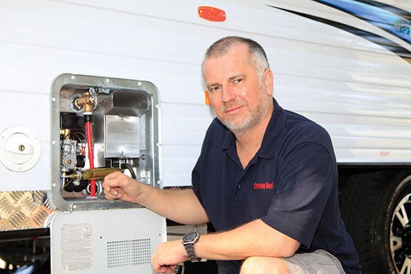

A gas hot water service is usually very reliable but it’s worth the effort to have a close look at the tank for leaks at where the element assembly seals to the tank body or where the tank halves have been joined at the factory.
