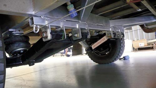

Upgrading to an independent suspension can be done in one of two ways. The first is a cut and shut method where the suspension is directly welded to the old chassis. This may require fitting new cross rails and shock absorber mounts.
The second way is to mount the suspension to a frame and fit the frame to the chassis.
With the increasing popularity of independent suspensions, we are performing more and more retrofits. Some of these are on older units and some are on brand new vans. Air independent suspensions can also be retrofitted fairly readily, which will give the advantages of independent suspension and allow the optimum ride height to be set no matter what the load. The idea that independent air suspension is for the upmarket buyer has been negated by its popularity and surprising affordability.
