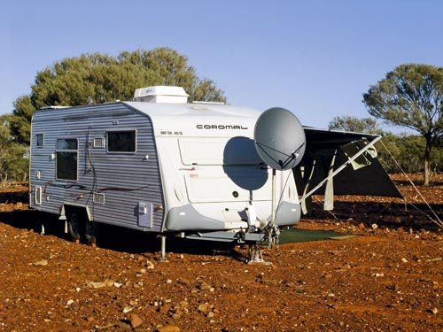

John and Dell Stronach, from Mackay, Qld, have a 6.5m (21ft 6in) Coromal Princeton caravan. They are keen gold prospectors and take their van, towed by a Pajero, all over Australia in search of gold. They stay mainly offroad, and for over a week in many places.
Dell uses a CPAP machine, which runs on 12V, and they have only one 120Ah AGM battery.
They have two 130W solar panels, which supply most of their power needs in good weather. They carry a Honda 20i generator for those rare times they require van heating/cooling via their air-con, microwave cooking, or when it is cloudy or wet. The inverter is used only to power John’s electric razor.
They have replaced all their lights, inside and out, with LEDs and instead of using their van’s ensuite shower pump, they use a less powerful submersible one, sucking heated water out of a bucket. This means they can use any available water, saving their tank water for drinking and cooking.
An old 12V drill has had the dead battery removed and John has converted it to 12V using a cord to his cigarette lighter point. Their TV (an LCD-LED model) and entertainment setup is permanently on 12V. He uses a satellite dish for TV reception and they do not carry an antenna.
They also pack their three-way fridge well, so they find they do not require a second one. It runs on gas when offroad. The CPAP machine has a dedicated 12V plug on Dell’s side of the bed.
