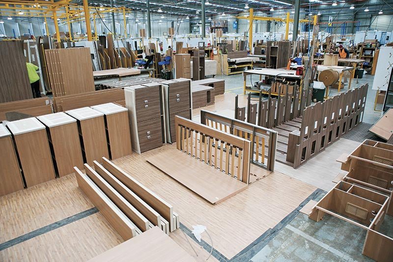

JOINERY
All Jayco cabinetry starts its life in the factory’s saw section. In order to keep weight down, all cabinetry and furniture is made of plywood or a ply/polystyrene sandwich. While solid timber furniture would send the weight of a caravan soaring, plywood, made from many thin layers of wood bonded together, is a strong, lightweight alternative. Weight-bearing furniture, such as dinettes, also get an aluminium frame for extra strength. The ply and sandwich blocks are bought from an Australian supplier that sources the materials from overseas.
The saw section is a huge space with more than 20 towering piles of different types of ply reaching halfway to the roof, and high-tech machinery constantly buzzing and cutting. Many of the machines are computer-aided, reducing the risk of mistakes and ensuring accuracy. But a small amount is also done by hand, such as edging and gluing a round table.
Some machines cut ply into smaller pieces, others cut shapes into them and some do the edging and lining of things such as shelves and benchtops. How many times have you stuck your hand into a caravan cupboard only to find the inside edge of the shelf hasn’t been sanded or lined? Not at Jayco!
Once the materials have been cut and edged, they’re delivered to the furniture assembly section on the production line..
FURNITURE ASSEMBLY
This area takes up a massive amount of space, right in the middle of the warehouse, and it’s a hive of activity. Jayco staff work on individual stations, each focusing on building one component. One person might be building fridge cabinets, while another assembles bathroom vanities and a third works on kitchen cupboards. A lot of plumbing is also done at this stage, rigging up the pipes to items such as bathroom and kitchen sinks and showers.
Furniture components that will house appliances, such as a fridge unit or even a sink, have the appliance pre-loaded into it before it goes onto the van. Once the components have been fully assembled, they’re dispatched to the production line to be installed. And, as caravans are built from the inside out, this happens fairly early on the line, before the walls are erected.
As a van moves down the line onto the furniture-fitting stations, every item of furniture and cabinetry that needs to go into that particular van will be waiting there, ready to be loaded. Small or light components, such as bedside cabinets or even empty dinette modules, are simply lifted onto the van’s floor, while larger or heavier components, such as fridge units, require trolleys and several people to lift them.
The furniture is loaded across several stages of the production line, and it’s all screwed down after the walls go up.
