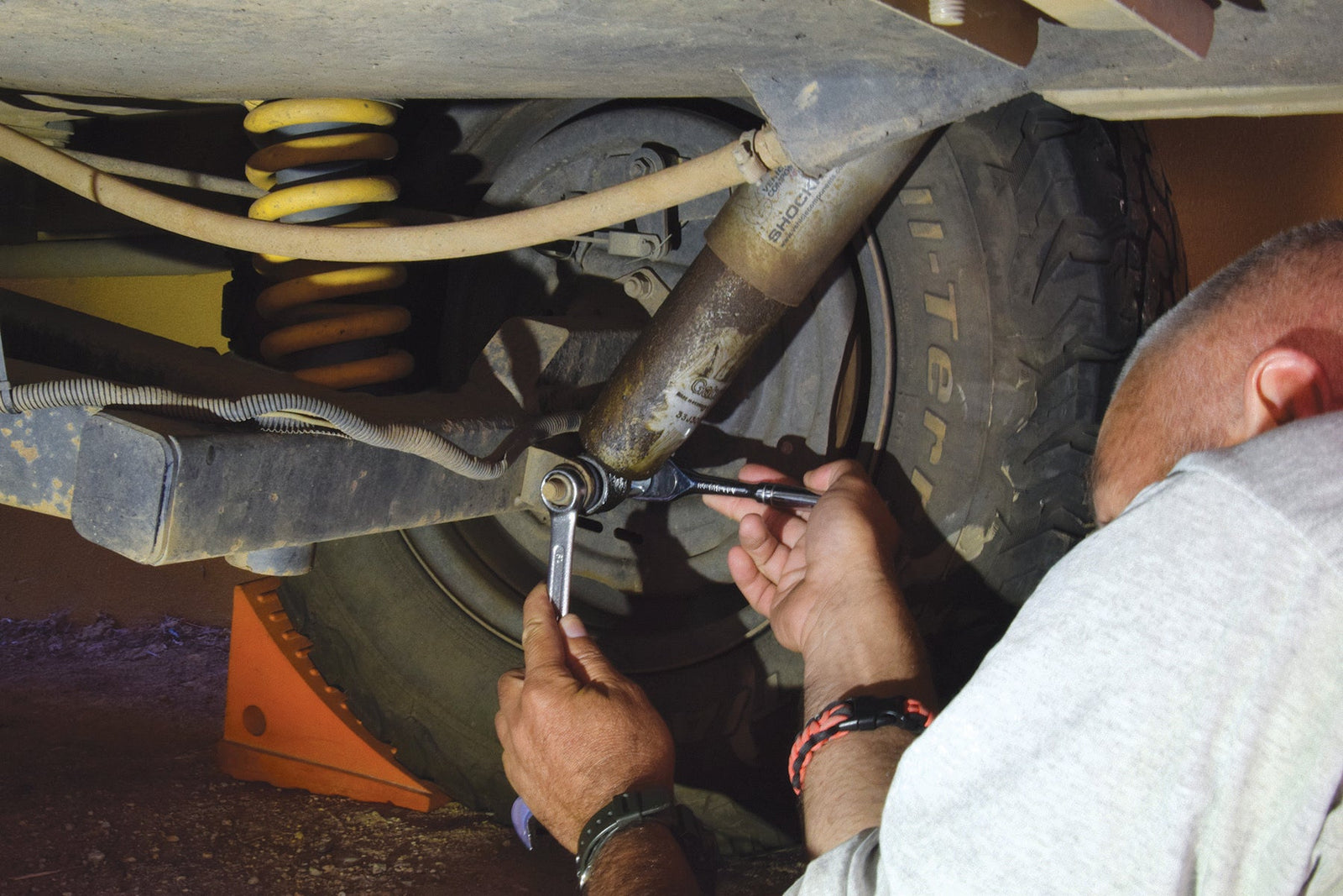

Believe it or not, the shifter and the spanner (or a socket wrench if you prefer) tools are all you’ll need to remove and replace a set of shock absorbers — but note the inclusion of the ‘defrustration-ometer’ and the ‘pry-open-omatic’, as they may come in handy too.
The fact is the last person who fitted shockies to your caravan was probably a mechanic in a workshop. So, they’d have used an air/pneumatic impact wrench, and it’s possible their efforts have pinched the bracket inwards. If so, you may need to apply a gentle tap or use the rigger’s wrench to pry open the bracket to fit the new shock.

First, remove the bolt from the bottom bracket and eye of your old shockie and repeat the process on the top mount. By undoing the top mount first, the thing may drop on your head or get in the way when undoing the bottom mount. In this example, the top mount was a spindle mount (not a bracket mount) so the decision was made for us.
