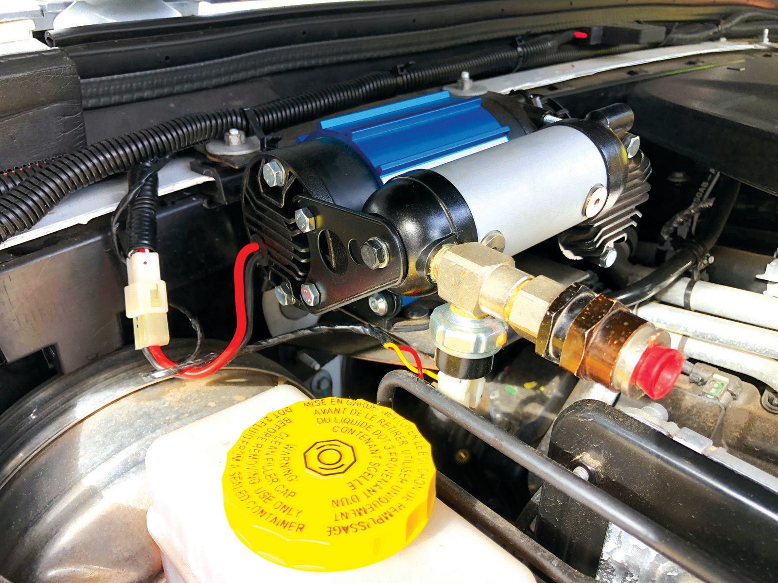

Even though you can deflate any tyre with not much more than a twig, you’ll still need a quality air compressor to pump them back up. Try to avoid cheap compressors, as they run out of puff and will struggle to reinflate your mate’s tyres too.
Normally I’d automatically suggest sticking with big brand names as they’re normally more reliable in pumping up multiple tyres, but I have used some not so famous units that perform admirably, so best ask around to see what others have to say.
For convenience, an air compressor can be hard wired to your 4WD (like I have) making it easy and ready when you are, though most are optioned with a bag for portability.
