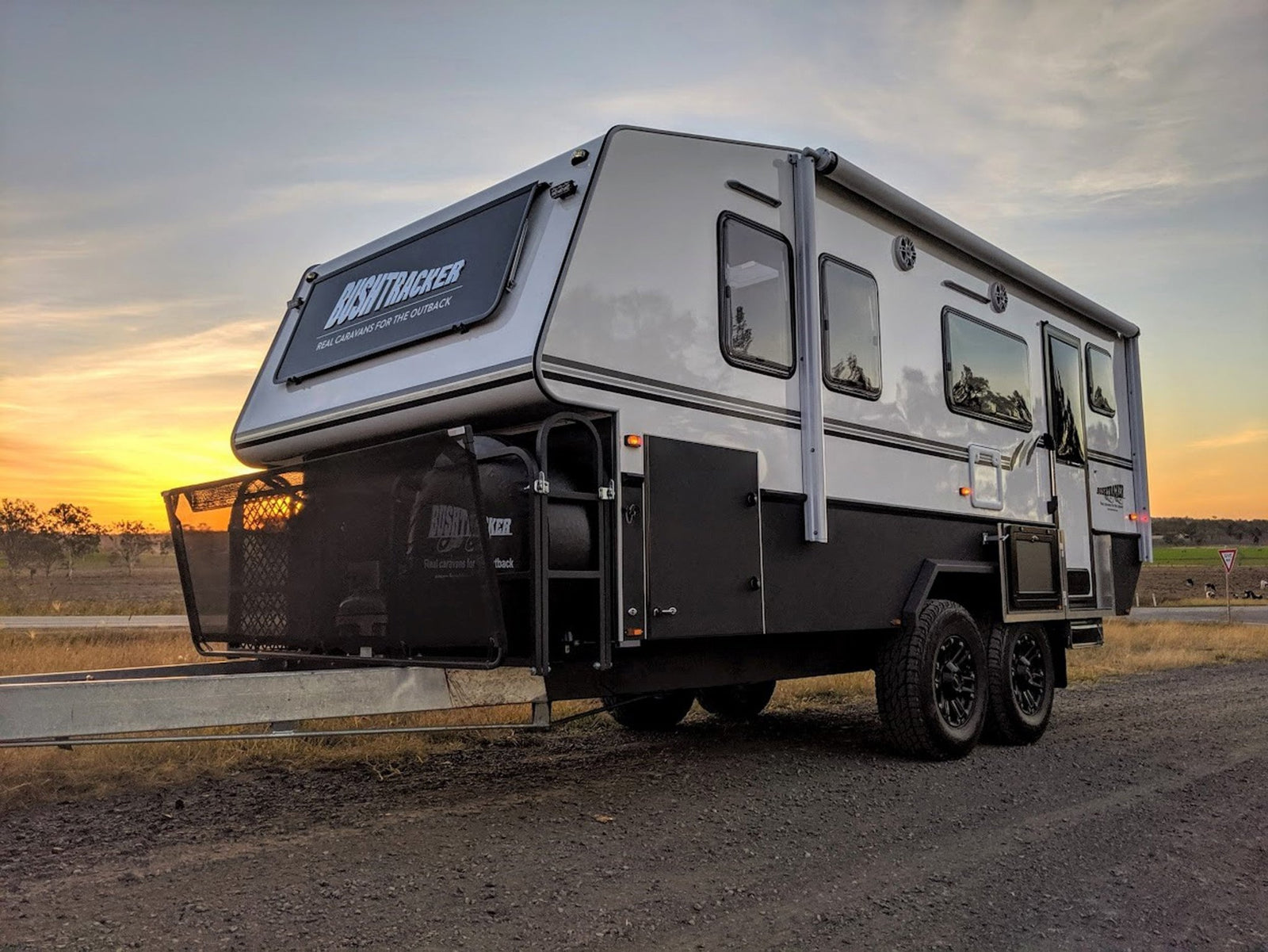

Bushtracker looks to the military for its suspension design. “Having used Simplicity independent suspension over a number of years, we reckon that given its military origins, it will go anywhere. One of our latest designs is a load sharing coil spring setup that uses progressive springs that gives a smooth ride over a range of loads,” Matt Kurvink said.

For the manufacturers who use a frame, aluminium seems to be the material of choice. Kedron, for instance, use a fully interlocked frame that has a welded roof and wall frames held together by steel anti-vibration henrob pins, fixed downwards and sideways by high tensile huck bolts. Sunland builds its frames from 25mm x 25mm and 25mm x 50mm welded box section aluminium, and Bushtracker does the same.
“For our vans, an aluminium frame is best. The frame is welded and bolted together and then bolted through to the chassis,” Kurvink said.

External cladding also seems to be the choice. Some manufacturers opt for the tried and trusted aluminium cladding, but others choose aluminium or fibreglass composite. Currently black or polished alloy checkerplate is the de rigueur lower wall protection choice of many a manufacturer who builds offroad caravans, but some specialists prefer to use something like a Raptor or Rhino coating — apart from anything else it’s a weight saver and, I reckon, looks better.

Creek crossings are something to be considered and while floors in particular need to be fully waterproofed, manufacturers like Bushtracker design their vans to be good for a 1.2m water level.
