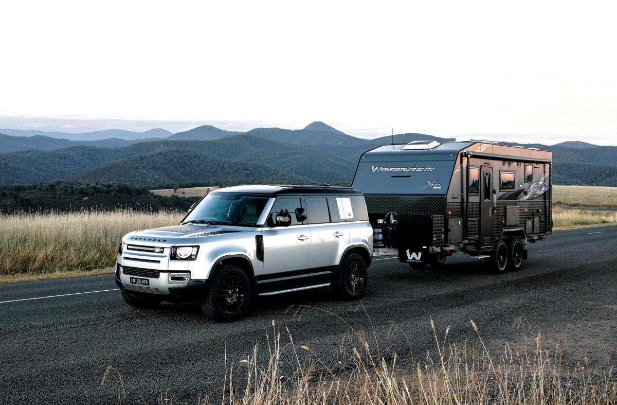

We never got to drive the VW Touareg seen in some shots, so cannot comment on it — but the stunning Landrover Defender 110 seen in some shots we certainly can. It’s not perfect, but it’s close, and let down only by the somewhat thirsty in-line six-cylinder petrol engine. Otherwise, it’s fantastic in so many ways — there are the looks, which draw positive attention at every bowser stop, and the interior feel which, aside from the flooring used, feels a lot like a Range Rover with Landrover’s top-spec outputs.
Consumption hovered around 22L per 100km travelled over nearly 500km driven. This was a mix of open freeway and driving in the tight and rolling hills of the outskirts of the Victorian High Country. I was driving for the photographers and videographers, which meant a lot of stop and go due to the tight schedule. I also had to make sure we got the van back in time to ship to its West Australian home. Taken together, the higher consumption didn’t come as a surprise. If you were touring, I’d expect a bit better.
The XTR itself was faultless. It never flinched, nor dragged the tail of the Defender even at 110km/h when returning the van via the southeastern freeways. No doubt the short overhang plays a big part in this, but don’t get me wrong — you know it’s there. It’s a tall van and imposing to traffic, which can be a good thing as other drivers do give you more space when indicating.
We didn’t take the XTR well off the beaten track. I wanted to, but being a sold caravan the closest we could do to test the ground clearance was tall grass, gravel roads, and the dry lake bed at Glenmaggie, which never challenged the heavy-duty Cruisemaster XT Air suspension.
